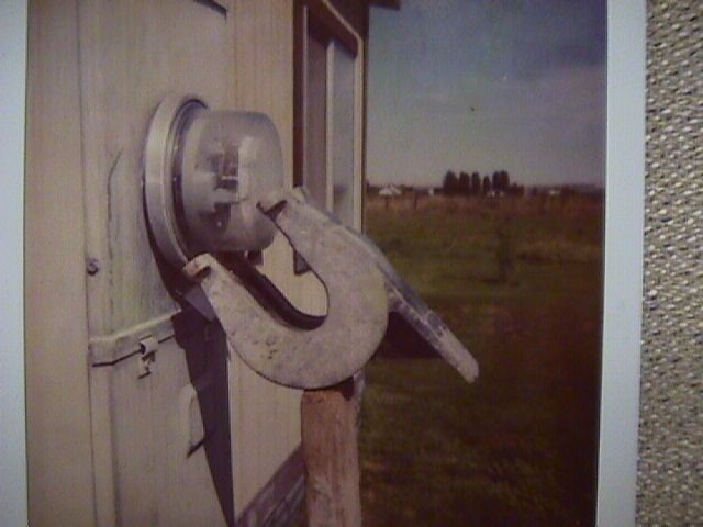

No exposed live parts here either, would you have wanted to be in front of this switch?
There looks to have been exposed energized parts in that switch and we do not know what triggered the event.
In general we do not require arc flash ppe to look inside switchgear, providing it is a 'look' and not 'touch' and there is nothing that might disturb the electrical field. That is 'in general' but there are also conditions such as excess spider webs, rusty or loose switchgear componentes where merely opening the door might constitute disturbing the electrical field.
