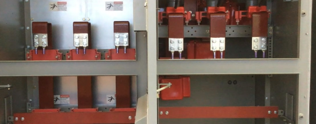

 Post subject: VCB Electrode Configuration?
PostPosted: Tue Jan 10, 2023 6:03 am
Joined: Thu Jun 09, 2016 6:17 pm
Posts: 11

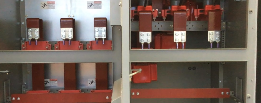

What electrode configuration would you utilize? I believe it is fairly straight forward for the bus section where the cables will connect (VCB). Although this is not a likely occurrence, is it possible that an HCB configuration could be valid if the bus insulation failed or the bus was uninsulated?
Thanks for your input.
