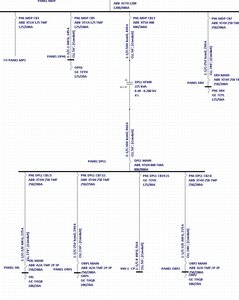

I think I found the same error.
For the intermediate energies, and AFB, I use Iarc_600 on the top, not Iarc_600_min. I still use Iarc_600_min on the right. This applies for the other intermediate values as well. See attached image.
How do I confirm with IEEE that this is the case?
