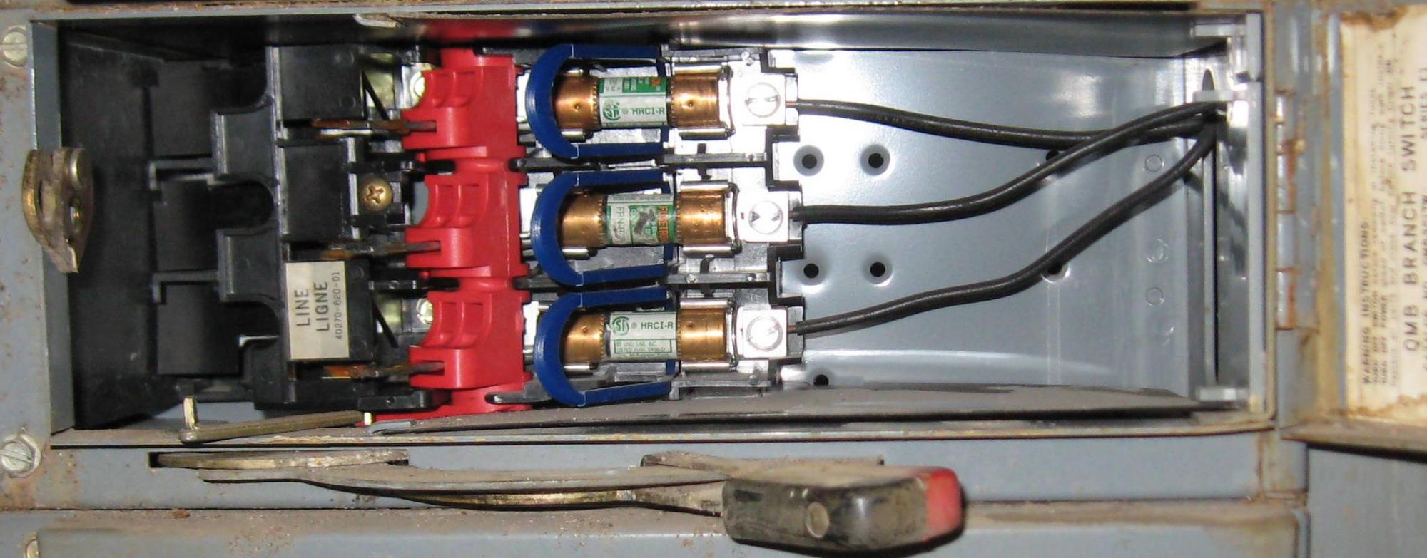

To update the group, we recently tested foam lined hard cap's (CSA Type II) at Kinectrics. We were responding to ignition questions within the industry. The two caps we tested (as per attached) provided encouraging results.
We presented the test results to the CSA Z462 TC at our last meeting in Calgary a few months ago.
Hope this helps!
