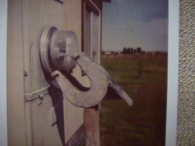

Long coat designs are protection concerns. For more information please see attached....
