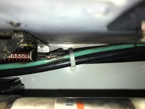

The attached image illustrates how these values are calculated from test results. As shown, one test point marked as a "fail" is slightly below the calculated ATPV.
