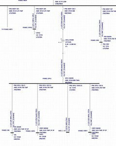

I have a small site built in SKM. I have a main breaker in a piece of switchgear then that feeds an I-Line panel. The main breaker has 10.39 cal/cm^2 and 93 inch flash boundary. 15 feet away the I-Line has 15.37 cal/cm^2 and 89 inch boundary. Does this make sense to anyone else. SKM said it was due to the Switchgear and panel designations. Higher incident value would always have a larger boundary right? Still does not ring right with me. Any feedback? Thanks

There are several possible considerations. What SKM told you is a possibility, depending on the type of equipment you have selected, enclosure size, bus configurations. It's not clear if your IE values are at the panel buses or load sides of the breakers. If your panel has a main breaker and you don't have "check upstream mis-coordination" checkbox checked, it may be basing the calculation on the time-current characteristics of the panel main alone. A system 1-line would be very helpful in providing more meaningful responses.

I think I got it put up there.
File comment: One-Line in question.
XFM #1 MAIN PANEL.pdf [19.95 KiB]
Downloaded 567 times

I also do have the check upstream device checked.

Did you try running it with the motor turned off?
There is something strange happening between Xfm#1 Sec (20.5 Cal) and #1 Xfm MDP Main Brk Encl (10.4 Cal).

The motor does not seem to make a difference. I assumed the transformer secondary is due to the cable. I have seen that before. The the other issue is throwing me for a loop. Just does not feel right.

So I removed the busses I am questioning and put in another bus with no data attached. The numbers seem right on that one. So I guess I am down to trying to figure out why a switchboard and a panel would have formulas to make the flash boundary go down when the incident energy goes up? That is what SKM said the software was doing but still does not make sense. Any thoughts?

Your datablock does not show the working distance, but unless you changed them, SWGR is 24" and PNL is 18" so that may account for the difference in IE.

That makes sense. Thanks, this one was confusing me.

And switchboards are typically treated as panels, for arc flash, due to their similar breaker and bussing connector. Switchgear usually involves drawout breakers with cable compartments in the rear of the equipment. Check the UL listing.
