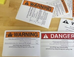

It happened once again! The all too familiar question was asked in one of my training programs: “What color should arc flash warning labels be?” This is a very common and sometimes confusing question because there can be more than one answer.
DANGER, WARNING, CAUTION, Red, Orange, Yellow?
Part of the confusion is that neither NFPA 70E or the NEC provide any specific guidance about what color or word to use for an arc flash label. Informational Note No. 2 found in NEC Article 110.6 references ANSI Z535.4-1998 Product Safety Signs and Labels, and NFPA 70E 130.7(E)(1) and Table 130.7(F) reference the entire series for ANSI Z535. This ANSI standard is where you find the definitions of the words Danger, Warning and Caution which are also referred to as signal words. According to the ANSI standard, each word with its appropriate color is defined as follows:
  • CAUTION (Yellow color): Indicates a hazardous situation which, if not avoided, could result in minor or moderate injury.
  • WARNING (Orange color): Indicates a hazardous situation that, if not avoided, could result in death or serious injury.
  • DANGER (Red color): Indicates a hazardous situation that, if not avoided, willresult in death or serious injury.
According to the ANSI Z535 definition, the word Danger with the color red, seems like the most logical choice for all arc flash labels. With the exception of a very minor arc flash, most arc flash events make the risk of serious injury or death quite likely unless proper protection is used or the hazard is avoided. But here is the problem. If every label had a bright red background with the word “Danger” on it, the importance of the message could become diminished.
The Two Color Approach
An approach used by many in the industry is to use both Red and Orange labels. Red with the word “Danger” is reserved for more extreme locations and Orange with “Warning” is used everywhere else. With this method, deciding when to use Red / Danger or Orange / Warning depends on the calculated incident energy.
NFPA 70E Informational Note No. 3 specifically references 40 cal/cm2 as an upper limit where more emphasis may be necessary with respect to de-energizing the equipment. This value is often used to decide which color and word to use. Equipment with a calculated incident energy of 40 cal/cm2 or greater receives a Red / Danger label and everything else would use an Orange / Warning label.

I recall a few of the arc flash programs allowed you to select other colors like blue, green etc. for labels. I don't think this aligns with ANSI Z535 as this article points out. Has anyone ever used these other colors? I'm not sure why they would be an option if we are only to use red, orange or yellow.

There is no defined standard as to when warning or danger arc flash labels should be used. As stated above, 40 cal/cm2 is commonly used. The ANSI Z535 should be followed, which means using a label with either a red header (danger) or an orange header (warning). Using yellow or green headers conveys a different meaning (caution and safety notice) and should not be used.
Secondly, a code compliant standard should be established and consistently followed for determining the type of label, for the label design, and for what information is included on the label. Labels need to communicate their information rapidly, clearly and accurately. Consistency is needed for this to be accomplished.

"Seriously, almost every manufacture of electrical power equipment puts labels on it saying:'DANGER - Hazard of Electric Shock' and recently they include Arc Flash. Then a study is performed and a Caution label installed. Yet, I never see 'work practice' telling which label should be ignored."
That is the reason we went from a Red/Orange/Yellow/Green System to using all red several years ago.
All of our labels warn not only of the arc flash hazard, but ALSO of a voltage hazard, as a result the "Danger" signal word, and it's associated color are required.

Our program was rolled out in 2008. In efforts to coordinate and simplify between the PPE required and the labeling, we chose to require HRC2-level PPE for both HRC1 and HRC2, and HRC4-level PPE for both HRC3 and HRC4. For the labeling, we used a blue heading background with NOTICE for HRC0, the yellow heading background with CAUTION for HRC1 and HRC2, the orange heading background with WARNING for HRC3 and HRC4, and the red heading background with DANGER for HRC Dangerous. The intent was for the craftsmen to easily recognize what PPE level was required by the color-coding, and to cover for those color-blind, by the label heading word.

As “professionals” with the help of ANSI we have caused more confusion than real answers. ANSI’s definitions for Warning and Danger are exactly the same. Ask three of us “professionals” the same questions and get three different answers. No wonder people are confused. I have seen Warning signs on panels that calculated well over 40 Cal. Then I have seen a Danger sign on a 240 volt 100 amp, single phase panels. I walked into a company this week that had Danger signs on every entrance door does that cover all hazards?
Personally, if my customer is using a two category PPE system (my recommendation) I also recommend Warning for Cat 2 and below and Danger for anything above. This way the “Qualified Person” knows they have to do more than their normal Cat 2 duty uniform.
I really believe ANSI needs to visit their definitions.
If we are talking about possible Death, I teach 59 to 60 volts is the level of voltage required to send current through clean dry skin. Therefore, 60 volts could be lethal. Given that do we need Warning or Danger signs on 120 volt receptacles? Manufacturers put electrocution hazard signs on even small 120 volt appliances don’t they? We could get totally crazy with this.
If we do not come up with some good solid answers and better rules, it will be in the hands of a judge and jury.
