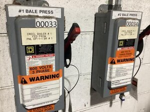

A side note, I have noticed that oftentimes control panels will have Class J fuses at their input terminals. I don't know if that is mostly to get a higher withstand rating for the panel or to reduce incident energy or both. For example:
