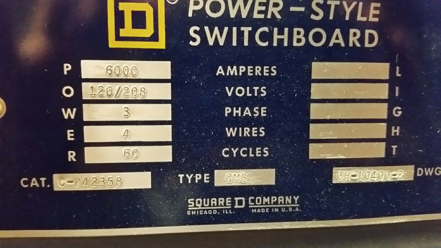

PostPosted: Thu Sep 03, 2009 2:08 pm
geh7752 wrote:
Specify that the electrical contractor has documented proof of arc flash training and is equipt with the proper ppe as part of the contract.
Yep, use this
