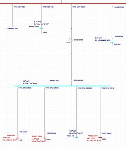

I think I figured it out.
I believe the FCT was forced because this was the bus or point between the Generator and the Generator breaker (no PD - labelled BKR-GEN lineside on the SLD).
I don't know if this bus should even be faulted. But this is what the consultant did.
And the '2 second rule' was because of:
A 2 second maximum arc flash duration is a reasonable cut off based on IEEE 1584-2002. It's the average time for a person to react to arc flash and leave the harzard area. So it's meaningless to calculate the energy after 2 sec.
Is this generally acceptable?

 Post subject: Re: Recreating old report into newer ETAP version
PostPosted: Sun Feb 17, 2019 5:15 am
The 2 second rule is something of a mention in passing and not so much a "rule" in IEEE 1584-2002 but became a practice. But in IEEE 1584-2018 came around it is now a prominent rule. It just one of many clauses that are more or less taken on blind faith simply because they seem to have withstood the test of time.
