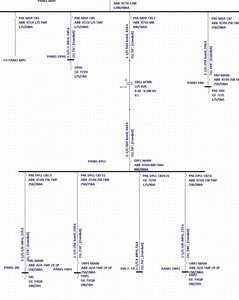

I know it seems like a rambling point, but there are only certain -requirements- given by NFPA 70E. IF you want additonal protection, you would have to consider the arc blast for crush injury and calculate the cal/cm^2 at closer than the working distances. I have done some calculations, mostly out of curiosity, as to the curves - if you look at the graph in the attached file, you can see the incident energy rises rapidly as you encroach closer to the source.
